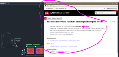

I'm guessing the extra file size is coming from the proxy objects.
The EXPORTTIAUTOCAD command gets the file to a lean 2.3 mg.

Interesting. I ran that on the Empty Drawing file and the result is 54 kB.
So then, where and what are the proxy objects? How did they get there? And how can I get rid of them?
