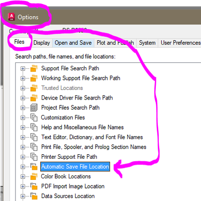

Patchy
已接受的解答
Options, Files tab, Automatic.....        it's in there.
Only if it crashed, you will not find anything.
Better luck with .BAK file

phyllis9007
This is as far as it goes. I don't see an \AppData\Local]\Temp or anything beyond that... I think I am looking in the right place, but maybe not? I have even done a windows search for the AppData and the Temp files with no results

pendean
Community Legend
Community Legend
@phyllis9007 wrote:
Unless your IT folks locked you out completely on your corporate PC (and if they did, you need to just ask them for what you need), most of us can get into our log-in TEMP folder with this folder address
%TEMP%
 or
0 个赞
7 条消息(共 13 条)
phyllis9007
YAY! Using C:Windows\temp got me into the temp file but I don't see any drawings in there and nothing with the .ac$ exension. I must need to designate a different file to save them so I can access them. Now I need to figure out where to enter the other file name.
