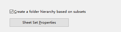

Hi there,
I wanna know what does "create a folder hierarchy based on subsets" mean when I create a sheetset? It seems no difference either check or uncheck this options.
Is something relative to subset?
Looks forward to your answer!
Victor
1,692 Views
imadHabash
From AKN ... This setting is not based on the subset name or hierarchy, but it creates folders to match the "New Sheet Location" property specified in the subset. If the folder specified is different than the sheet set root location, a new folder is created.
Imad Habash
Hi I have checked this option and create a new sheetset, however when I created a new subset and chose a new sheet location and then created a new sheet, there was no folder was created only a drawing.
