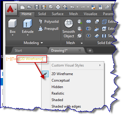

let me ask one thing before: why do you need that combo with visual styles when you can have that always in the upper-right corner like here:
This is more close to your drawing area (modelspace as well as every viewport).
I do prefer this way to avoid too many icons in the QAT, otherwise it wouldn't be "QUICK access toolbar") 😉 Maybe it's for you ok too.
