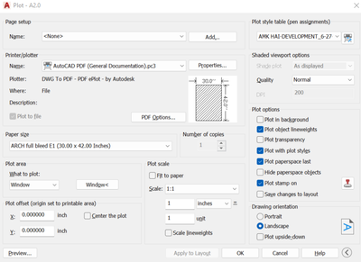

Inside my specific viewports I have certain layers frozen and others not frozen on the same drawing to show different information, when I SHIFT + RIGHT CLICK all sheet tabs in paper space + Publish Selected Layouts and print a set of sheets, the frozen layers appear on the plot. If I type PLOT and set up the print individually, however, the viewport layers remain frozen and all is good. This is not ideal because I want to be able to publish all sheets at once. When I save the drawing and close and reopen the drawing all frozen layers return to their base states which means I would have to refreeze each layer every time I want to print the sheets.
1. VISRETAINMODE = 1, 2, 512, 2047, doesn't matter I tried them all.
2. The object that has frozen layers is an XREF and is being frozen through VIEWPORTS in PAPER SPACE. Each viewport has different layers that are being frozen.
3. My External References in the OPEN AND SAVE tab of the OPTIONS menu looks like this if it matters:
How do I get them to print in the publish selected layouts?
How do I get them to save between sessions?
Why does this happen so I can stop it from happening again?

Page setup:
ACAD is up to date

I'm checking my visretain settings, I publish all the time with no issues and my settings are:
  • VISRETAIN = 1
  • VISRETAIN MODE = 0
I suppose you could attach a couple CAD files so I could test them out on my machine. You could also try to uninstall/reinstall AutoCAD.
Message 7 of 10
amkus2
I just tried changing my VISRETAIN to 1 and that fixed the freeze issue, but it causes another problem down the line when I change an XREF layer in the origin file and it does not update.
