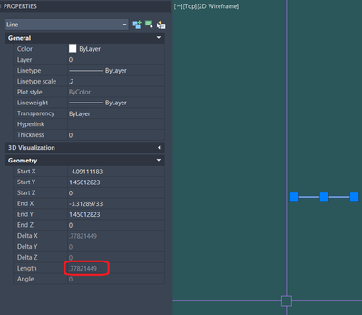

julia3683
Hi, The Software is AutoCAD, And it is Property Panel. I used be able to type in the "Length" value and change the length of a line.
Select a existing line shown in the below image then go to property panel, change the length value.
This worked in up until AutoCAD 2023, but not AutoCAD 2024.

Kent1Cooper
@julia3683 wrote:
Hi, The Software is AutoCAD, And it is Property Panel. I used be able to type in the "Length" value and change the length of a line. .....
It has never worked that way in regular AutoCAD, in my memory, going back 40 years [actually less, since the Properties palette hasn't been around nearly that long].  Maybe you were using some overlay program that had some special feature....
The length Property is only a result of the locations of the endpoints -- you can change those in Properties, if you know where to change them to, or one of them, if you know which one.  The Properties palette shows it, but only because it calculates it from the endpoints -- it is not something that is stored in any way in the Line's data.  As @cadffm asked in Message 7, if you were to be able to do this, which end of the Line would move to result in your desired length?  Or would both of them, with the midpoint staying where it was?

Kent1Cooper
@julia3683 wrote:
.... what I meant was I can change value of object from there. ....
You can change some values in the Properties palette, but you have never been able to change just any value you like.  As pointed out, you can't change the length of an Arc that way, any more than you can for a Line, because it is only the result of the combination of several things you can change -- the radius and the starting and ending angles.  That's why some values are "greyed out" in the Properties palette -- those are the merely-reporting entries, not the object-defining ones.
If you want to get a sense of what you can and can't change there [apart from the visible indication of greying out], study the DXF Reference for the object type in question.  It shows you what pieces of information are stored in the entity data for the object, which is what AutoCAD uses to put it on the screen, and to generate what is needed to plot it.  Basically, those are the things you can change in Properties.  The length of a Line [or an Arc] is not among them, because they are only results from the information that is stored.
