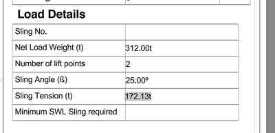

Hi all,
I'm looking to use a formula in autocad table to caluculate a value, i need to use sin and pi values, can these be expresses in a table in paper space on a template?

andy.clarkeLAA4H
Hi ,
So, the formula below works in excel, the "SIN" & "PI" are values(in excel), the table below shows that by entering the vales in the green cells gives the required results,
=(B39/C39)/SIN((90-D39)*PI()/180)

andy.clarkeLAA4H
Hi again,
apologies, first time on here,
Load weight = B39
number of lift points = C39
sling angle  = D39
the formula is in the sling tension cell has the formula, "*PI()/180)" this converts radians to degrees in excel, is this required in cad if this works or can i just get away with needing the SIN value?

This is actually quite simple with a field in your table:
You can play with the formatting in the cell properties:
I have added a drawing with a demo table

andy.clarkeLAA4H
that works great just how i want it to in your table, i have already set up a table but the formula is done vertically, still cant get it to work, am i missing something,

Michiel.Valcke
I noticed while playing around with your template that changing the formatting of the cell value does have an influence on the calculated value. So conversion might be necessary, but it looks in working order to me.
In your original drawing you missed one cell designation (C2 should be B3)
