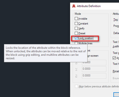

There's the option Lock Position:
Don't know what will happen to existing inserts when you change this, so give it a try?
