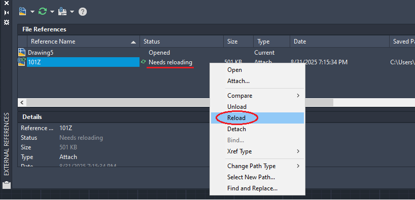

4. Back in your working drawing, enter XREF on command line=>go to External References Palette. Your xref will display Needs reloading. (Refer to Image-2.) Highlight the the xref's name=>right-click=>Reload.
Image-2Image-2
The attributes in the xref will now be INvisible and the block attributes in your working drawing will remain VISIBLE.
