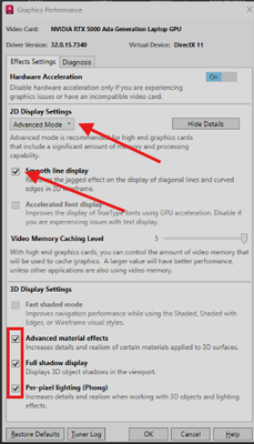

The initial screenshot shows 3d image which is set using one of VSCurrent's shade styles?
Are you currently running DirectX 12?
Enter GraphicsConfig command, do a screenshot & share that here.

lbellino4
This is what my computer shows.
Message 14 of 19
paullimapa
Looks like you’re already running Directx11 this eliminates Directx12 as the cause for the lockups

@lbellino4 Experiment with changing these
