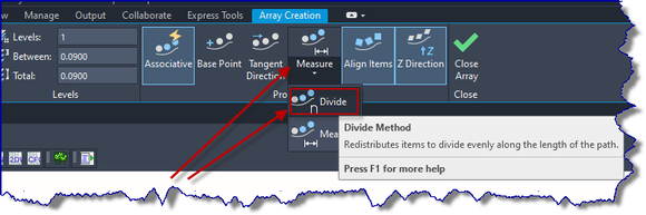

>> however spacing is not the same
The spacing is the same, just at the end of the polyline there is not place enough for twice the distance.
If you want to have the circles not distributed by a fixed distance along the path, but instead dividing the path into equal segments, then change the option to "Divide" and control the number of elements instead.
- alfred -
Alfred NESWADBA
(not an Autodesk consultant)
Message 8 of 8
User__CAD
Thank you Alfred this worked!
