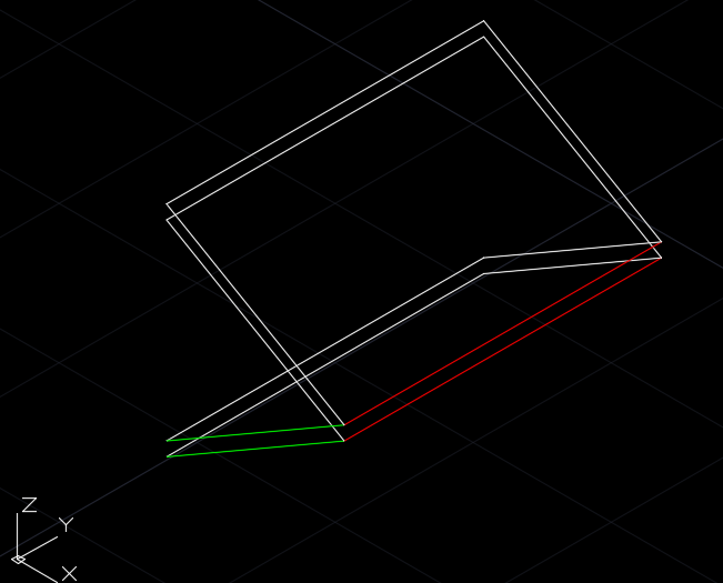

Note, when you offset in Z you will have segments that are of different widths.  For example, in the image below the red lines and green lines are offset in Z by the same amount but the perpendicular distance between the red lines is greater than that of the green lines.
Converting pairs of offset lines to surfaces with loft and then using thicken to convert the surfaces to  solids and then unioning the solids may yield the following:
