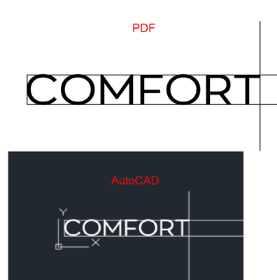

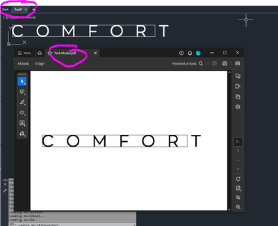

I'm trying to give precise spacing to some mtexts but I have the problem that after PDF print the spacing changes.
In the image below you can see three screenshots: in the upper part the model screen, in the center the print preview and below the pdf.
Anybody know a solution?

Your PDF has a font substitution perhaps: you'll need to share that DWG snip and the PDF you created for examination.

@tonytwok wrote:
Ok, I attached DWG, PDF and the font. To print I used DWG To PDF.pc3.
Thank you for the files: your DWG file opened here looks like your PDF. What's missing from the file you posted compared to the earlier screenshots?
And are you aware every recipient of your PDF that does not have your font installed on their PC or MAC will never see the font in this style either? As long as you embed fonts into your PDFs anyway.

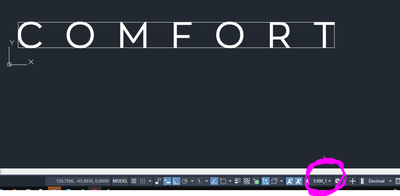

tonytwok
In my AutoCAD the text it's inside the rectangle:
Why this difference from your? Do you installed my font?

If I remove the character spacing on the string, it plots the same as it looks on screen.
Message 12 of 17
tonytwok
You are right, but in this job I need to maintain the spacing I selected to fill the text inside a square.

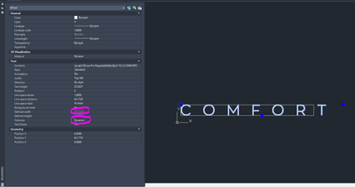

Still doesn't explain why we can't see what you see in AutoCAD.
Also:
1) why is COLUMNS>DYNAMIC in use in your one-word MTEXT?
2) Why a set width?
3) what is your custom CTB file adding to the plotting?
4) If you are plotting from modelspace (that's what your PDF says), why is there no saved printer? No scale? wrong page size (portrait is saved, you created landscape PDF)
5) what is this setting for if I may ask? It does not seem to do much
if I adjust your TEXT to fix the rectangle
Then PLOT with these choices
I seem to get a PDF that completely matches the DWG

james.jinan.xue
Hi @tonytwok and @pendean , sorry for the confusion.
The issue is reproducible in AutoCAD 2025 for TrueType Text but not in AutoCAD 2024.
The workaround is to switch to "Intermediate Mode" for 2D Display settings in GRAPHICSCONFIG dialog.

tonytwok
Thanks, you found the solution!
