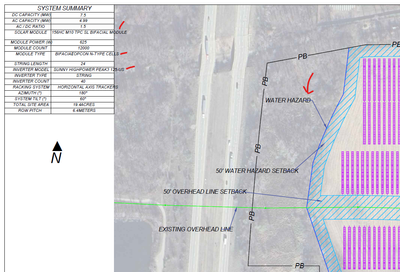

Hi there,
My drawings have recently had a change in text style. I thought this might be due to an update occurring within CAD. Now when I am working in paper-space, the text is fine, but once it's printed it is all mis-aligned causing it to run over lines. How can I correct this?
Text in CAD:
Text when printed:
Any help would be greatly appreciated. Thank you!

Message 3 of 22
CallumMX9DR
I don't believe the images have an impact. I deleted the image files from CAD and it's still printing slanted on my end.
Could it be possible the text is slightly rotated within 3D space causing it to print in italics/off the page? I've been using this CAD Template for almost a year without issues to text mis-aligning at print-to-pdf. Very odd!
Thank you for the assitance!

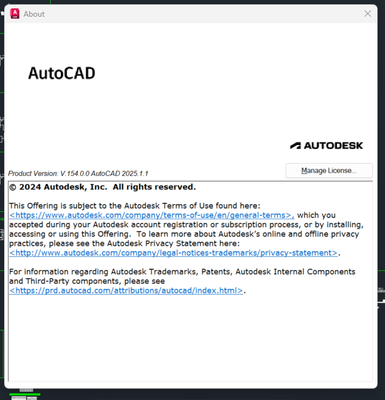

Should not be the issue since I don’t have that problem. What version of AutoCAD are you running and do you have latest updates installed?  Enter About command do a screenshot and share that here
Paul Li
IT Specialist
@The Office
Message 5 of 22
CallumMX9DR
 Here's what I'm operating on

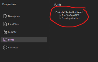

pendean
Community Legend
Community Legend
@CallumMX9DR You have a font substitution issue in your PDF, nothing more: share that actual file here, let's see what is behind that from the settings you opted into.

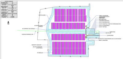

Message 10 of 22
CallumMX9DR
Attached are both the CAD and PDF file, I wasn't sure which one you wanted to see. Happy to hear it sounds like it could be an easy fix!

pendean
Community Legend
Community Legend
@CallumMX9DR wrote:
..Happy to hear it sounds like it could be an easy fix!
Easy? Well, your PDF clearly shows it has a substitute font in use from your customize-to-you PC3 file
Since we that use 2025 over here cannot replicate your PDF output issue (see attached), my guess is you have a rogue PC3 file. Try the other PDF drivers you have installed.
