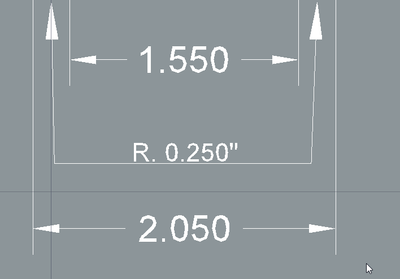

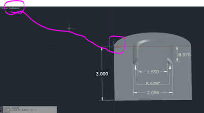

Good Morning,  Somewhat new to AutoCad.   I have created a 3d Object, and split in half for adding dimensions.
I have text on the face of the object, and some text off to the side.   The text on the face displays as an outline on the drawing, and the text on the outside is solid. When plotted to PDF or printer the text on the face of the object becomes blotchy and removes some of my dimensioning lines.  The text and lines on the outside of the object plot fine.  Would this be a text issue, or layer issue?

See Below Screenshots.  Top two are from the plotted version.  I have tried to change the draw order and send my object to back and pull text to front.

"Would this be a text issue, or layer issue?"
I'm not certain, but this is probably a display (graphics, driver) issue which causes a printer issue.
The problem (maybe obviously) is that the dimensions/text coincide in model space with the 3D model surface, so AutoCAD has some trouble "deciding" which objects should get priority.
First, check to make sure all your drivers are up to date.
You can move the dimension/text objects away from the surfaces by a small amount and the display should improve and the printing issue should go away. (But this will break the associativity, which you might not want to lose.)
You can also resolve this by dimensioning views of the model in paper space.

paullimapa
What I would do is goto Layout and inside the mspace vport select all the dimensions & text and execute CHSPACE command bringing those objects into Layout.
Then when you plot, you'll get the shading of the 3d model but with the Dimensions & Textlooking normal (see attached).
