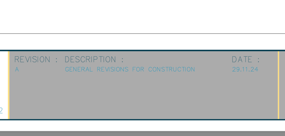

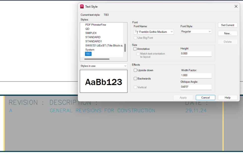

Hi there
I have a problem with my text. for some reason the Franklin Gothic Med that i use has unlinked from my text in paper space. i have checked text style manager and it is correct in there and i can manually change it and looks correct as you can see below, id like to link this to save me changing it on every sheet and in every project, please see the pictures below.
as you can see from the photos i can manually change the text so its loaded i just want to know how to update them to relink automatically as i have many sheets and many projects
Any help is greatly appreciated !!!!

Any difference if you turn Fast shaded mode off using the GraphicsConfig command?

No difference , I'm assuming below is what you are referring to
it is also worth noting the next isn'tScreenshot 2025-01-16 114327.pngScreenshot 2025-01-16 114344.png displaying in plan also

Can you enter ABOUT command, do a screenshot and share that here as well?

Looks like someone (or you) edited or copy/pasted your MTEXT from another source, nothing more

that may of been the case .. unsure , although is there a way to group fix it without going in and editing each text is the answer I'm searching for

You may want to try updating to 2025.1.1 to see if that makes a difference

cadffm
would you please share this file?
if not:
1. You didn't confirmed that the style is TB3, select the mtext and check the style, CTRL+1
2. What you do in your picture is to overwrite mtext properties with internal mtext formats, that's not what you want, trust me.
Sebastian
Message 10 of 10
paullimapa
You can also try setting Gfxdx12 to 0 then close and restart AutoCAD LT and see if opening that same dwg still has that problem
