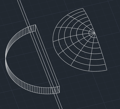

I created a surface and then trimmed it. I wanted to move this trimmed surface
but when I did the surface reverted back to its original form.
Here's pics...The first one shows the trimmed surface and the
second one shows what happened when I moved it.

Pretty strange behavior. While I look into this, a quick fix is to convert the revolve surface to Nurbs and then it moves properly.

It appears that you have created an associative trim for that surface and somehow eliminated whatever you used for the trim making the surface use last known locations for the trim.  When moving the object it re-trims relative to that object.  I didn't know it was possible, much less what to do it about it now.
I do however question your methods, 2D plines with thickness, and strange surfaces are difficult to manage, in my opinion.  I find using actual 3DSOLIDS much easier to manipulate.  Instead of changing the thickness of the 2D pline, extrude it to the proper thickness as a solid.  instead of creating a revolved surface, revolve a closed pline to a solid or trim a sphere of the proper diameter and height.

For some reason I was able to move the curved surface without it reverting to its past shape the last time I tried it.
"Pretty strange behavior. While I look into this, a quick fix is to convert the revolve surface to Nurbs and then it moves properly."
When I started exploring surfaces in 2015 the tutorials explained that there were different states
of association and I wonder if that is what is going on. If I am going to move things around should I go to a Nurbs surface?
rculp, you have a point about solids but I just want something to be able to go through ideas quickly.

It's 2025 and I checked this thread for a similar problem and solved it a different way.
Problem: i created an orange cutting plane to trim my gray surfaces, when I delete the orange cutting plane the trimmed surfaces become untrimmed.
My solution:  Before deleting the cutting object, right click the trimmed surface and go to properties, at the bottom under ASSOCIATIVE TRIM click the drop down menu and "remove".  Then you can delete the cutting object and your surface will remain trimmed.
