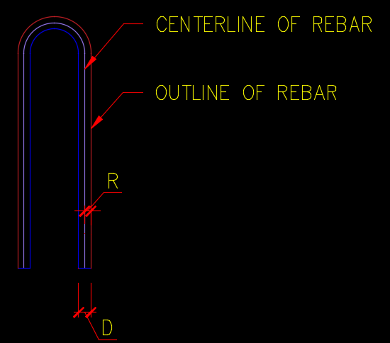

How do we find out the total length for a bend part in Auto Cad.
I need a solution apart from adding the sum of all the lengths individually i,e make the bend part appear straight in autocad.
The diameter is 8.00 mm

leeminardi
If you create a single polyline down the center of the bar you can use the LIST command to give you the total length of the polyline.  To get the total unbent length you would need to factor in the bend allowance for each bend using equations such as those here:

See the picture below:
Just join all of the line segments that make up the outermost line of the rebar, the offset that the radius of the bar and then LIST the new polyline in the center of your bar to have AutoCAD tell you the length of it. This is a really easy thing to do.

Washingtonn
You are assuming that the neutral axis is located at the center of the rod which is seldom the case when it comes to bending thus the starting length before bending will be different but the difference may not be significant to the OP given the tolerances indicated.
The neutral axis is dependent on such things as the material involved , how the material is bent, and the bend angle.
The K-factor is the ratio of the distance of the neutral axis (from the interior bend side) to the material thickness and is typically 0.25 < K-factor < 0.50
