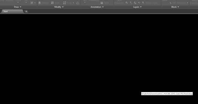

This is how my Start tab looks like. Small white box on bottom-right corner is the location of my mouse pointer and it indicates that the recently used drawings list is existing there. If I click at that location, the drawing opens as well.

Yes, I understand. What I'm saying is that this 5+ year old application was not designed to handle 4k. Some of the updates *may* fix certain parts. Perhaps they never fixed the start tab for 4K.
Have you opened a support ticket with Autodesk?
