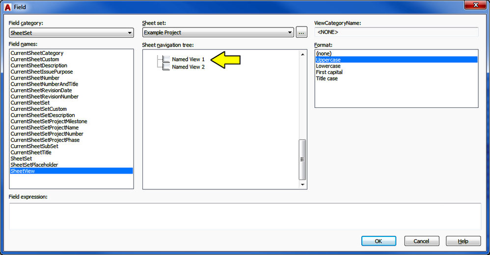

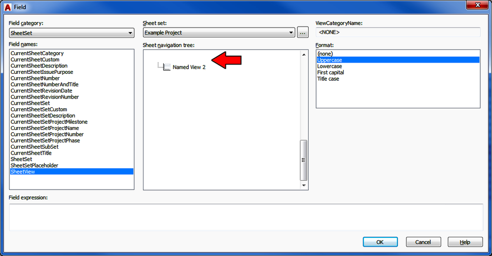

This has happened so frequently, I am desperate for an answer.
We have no problem creating named sheet views in model space and then placing those views in paper space with label blocks containing linked fields.  It works great.
However, mid-project, sheet view names in the navigation tree will simply disappear, and the label blocks associated with them are replaced with #######.
Any ideas ?
Field Dialog Box Before:
Label Block Before:
Field Dialog Box mid-project (named view missing):
Label Block mid-project:

4) The last two named views are not acknowledged by SSM, although they were originally.  You will not see them listed in the
     SSM Sheet Views Tab.
5) Subsequently, the label blocks in A1.03 - BUILDING 100 DEMO CEILING PLAN AND REFLECTED CEILING PLAN have been replaced by #####.
6) Those label blocks in A1.03 should read BUILDING 100 DEMO REFLECTED CEILING PLAN on the top and BUILDING 100 REFLECTED CEILING
     PLAN on the bottom.
7) Since SSM doesn't acknowledge the named views, it is impossible to repair the label blocks.
I hope this makes sense.  We don't understand why these views disappear, mid-project.
Thanks again.

Thanks for the files. I am looking at them to see if there is a way to repair the views  but while i do so,m I thought I should mention that your base file did have 4 Audit errors and a bunch of regapps that were purgable.  This might be the root cause of this issue.
I noticed that if I re-place the model views in the A1.03 file then everything works again.
John Vellek

We have audited our drawings and purged the regapps per your suggestion.  Thank you.
I am curious how regapps become embedded in the drawing in the first place (??)
None of them were recognizable to me.
Yes, we are aware that we can replace the model views, but that is the time-consuming process we want to avoid.
Also, one curious thing.  If a viewport references a named model view, and is associated with a fielded label, and if the viewport is mistakenly erased but immediately "oops'd" back in, all field data is permanently destroyed, and the named view is not retrievable in SSM.
