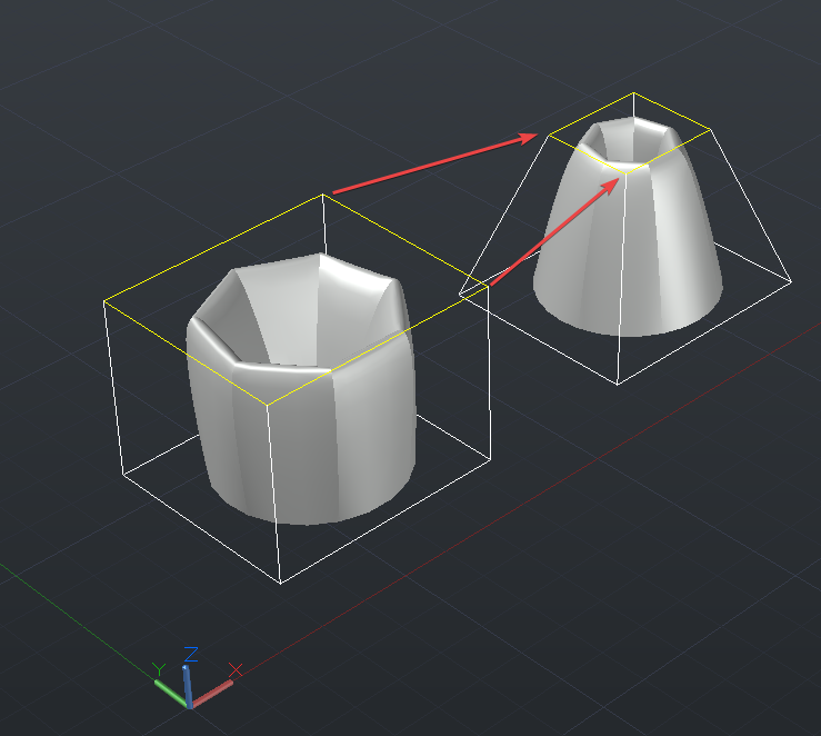

I'm new to Autocad and want to know if there is a way of doing following transformation to solid:
Please note that I want to do that transformation for other solids with much more complicated shapes. So I'm looking for a method that works for any solid regardless of its shape and properties. By the way, how is this transformation called in theory?
I'm using Autocad 2017 for Windows 10 desktop.
Thank you.

Hello @Anonymous,
Sorry for the delay. The 3d modeling command for this would LoftCreates a 3D solid or surface by specifying a series of cross sections. The cross sections define the shape of the resulting solid or surface. You must specify at least two cross sections. Loft cross sections can be open or closed, planar or non-planar, and can also be edge subobjects. Open cross sections create surfaces and closed cross sections create solids or surfaces, depending on the specified mode

Lofting is a great suggestion by @natasha.l  as long as you have the right profiles to target.
However if you are trying to "transform" from one shape to the other and do not have profiles you may be using the wrong software.
The example you show can be described as an XY scale at the top of the solid model in a transitional function.  If the  original model were developed in Inventor you could modify things at the sketch level and the model would update as you make alterations.
If you are married to AutoCAD (fine in my opinion), you could "Extract Edges" from your initial model, then modify the edge profiles as desired, then re-Loft.
