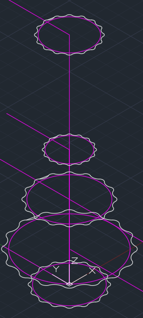

I'm trying to make a vase, but I'm not sure how to create a solid (able to hold volume) from the several 2d objects along the Z axis I created.
I know there is lofting, sweeping, revolving, extruding- but I've only been able to accomplish these actions on a single object.
Pictures: Left is the product, the right picture is where I'm at.
If anyone would be able to assist that would be much appreciated.

The problem could be here:
Message 5 of 9
Using LOFT (with more detailed cross sections to define all curve directions) create the outer fluted solid (white closed entities), then create a second solid from the magenta circles and SUBTRACT the last from the first to create the interior.

Thank you both for the responses.
I'm having a problem with the segment that you pointed out Patchy.
That area (an arc) will not turn into a polyline for me with Pedit. So I have a line that exposes the vase (hence it's just a surface at this point)

I thought my attached dwg already fixed that.
How about this one?

Thank you very much Patchy!
It's all cleared up now.
