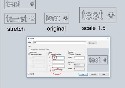

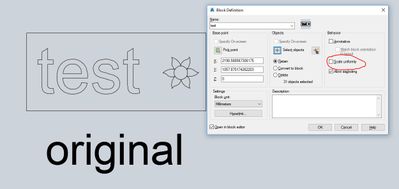

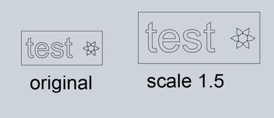

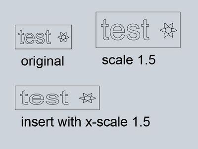

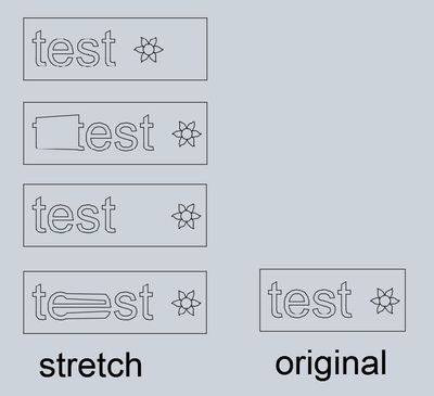

If you wish to reduce the size of your objects along one axis, then usually stretch will be the go-to command. However if you wish for other elements in you drawing to reduce in size proportionally along the same axis you will need to do a work around.
You can turn your objects in a block (_BLOCK) and then insert the block again (_INSERT) but scale it along a single axis (for example x=1 y=1.5) then you will have effectively stretched your entire block along a single axis but unlike stretch all parts of your drawing will have stretched proportionally along the same axis.
I have added some screenshots to clarify the difference, as well as my .dwg in which I made the test. It still contains the block 'test' so you can practice there for your insert.
