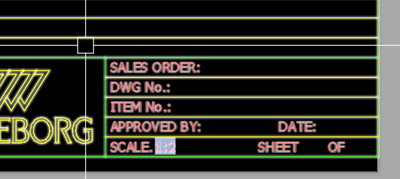

My boss has had a play with a template and got rid of the scale attribute on the border - it now references the DMS system instead of the DWG. I was wondering if someone could help me reset it back?
File attached.

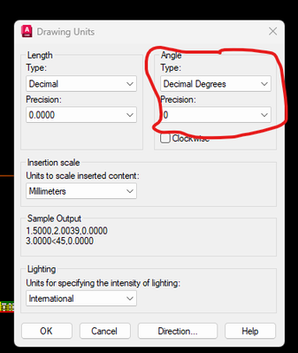

Did you check Units settings?

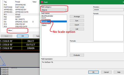

FYI, I'm trying to follow your instructions but when I BEDIT Block Name: "REG" which is the Title Block with all the attributes, the ATTDEF R11 represents Scale but has no default value:
Then when I Right-click, go to Insert Field, and select Objects > Formula I don't see a Scale option:
The only place I find a Scale option is when I Right-click, go to Insert Field, and select Document > Scale

Try BATTMAN to update the ATTDEF in the title block.
