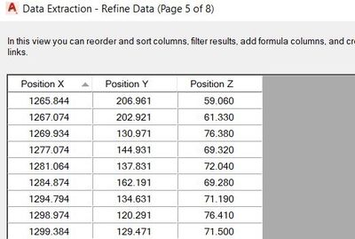

ara_neresesian
HI
just want to say that kinds of text, and point belong to an old under DOS application which called
"SDR MAP" , but there is a setting on that software  which can export the text correctly  not like this ,
maybe you ask them to change the setting if you have to do kind of jobs, if you can ask them to export as a 3d  point not flat like  this.
And if you are using civil 3d to make a surface you dont need to make a cvs file,
You can import it directly to civil 3d
use this methods  see pic.
something else ,if you need a cvs file to make cloud ,you need only points (Alfred NESWADBA sent that file)
and with "dataextraction" in Aurocad you can export the points data  x,y,z to a file (the text are't necessary).
