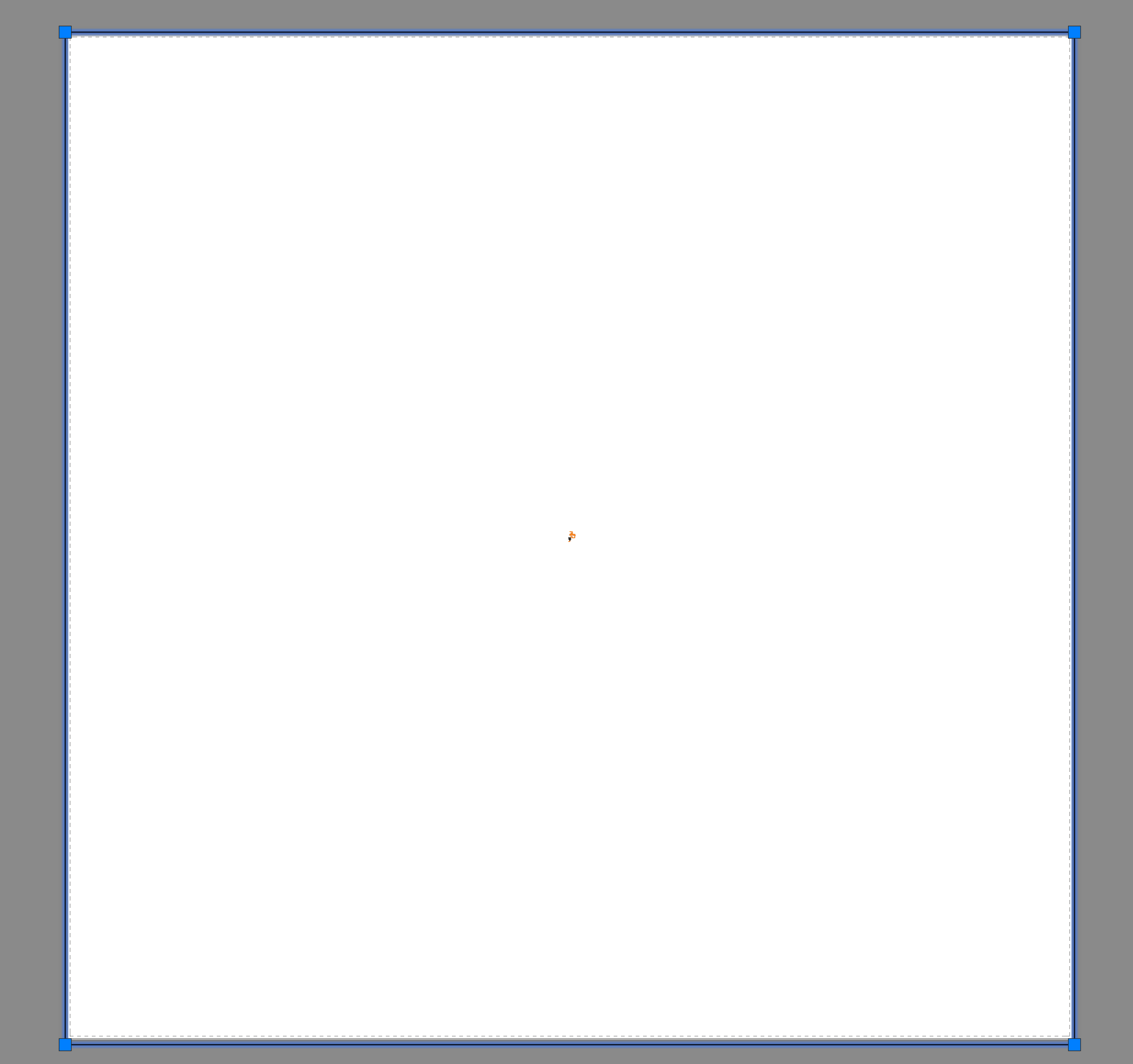

Hi everyone and thank you so much on beforehand for trying to help me out here.
I want to print a plan drawing of a city on a 90 cm x 90 cm paper in scale 1 : 10.000. All is set, but when I press scale 1 : 10.000 (or any other scale for that matter) it scales completely wrong, waay too small as you can see. I have drawn in meters in the model space, but the plot window is as you can see set to mm.
Thank you very much for your help, it is very much appreciated!

A first quick shot into the dark: Try a scale 1:10 (istead of 1:10000). Because - if you have drawn in meters you have already drawn 1000 times smaller than if you had drawn in mm.
