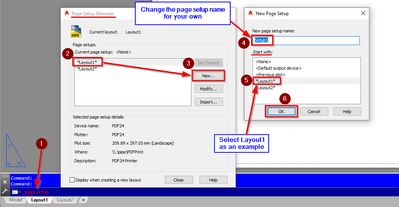

can someone please explain this stuff to me, apologies for being extremely ignorant on how this stuff works. I am not an architect or designer, I have no specific training in this field. I am an Arboricultural consultant/ surveyor. I usually use other peoples drawings, topographicals, architects drawings etc. I simple add into these drawings root protection areas and canopy distributions of trees on the site. Occasionally I do not have the benefit of working with an architect.
so, this drawing i am doing by myself. I have set the units in model space to metres. I want to now export this to a pdf that will be a suitable scale to print @Anonymous. I go to layout 1,  I would like the drawing to fit onto A4, the site is approx 76 metres by 81 metres.
how do I accomplish this correctly ???? help very much appreciated

I need to scale everything back down by a certain factor so as the radius of that RPA (T1) is 7800. How do I work that out mathematically?
Based on your scale bar you need to use command scale to scale 30000mm to 30000 units by selecting everything in model space. (Please have a look in HELP for the scale command.)
Currently 30000mm represents 762000 units on your drawing.
After changing the drawing scale your drawing will be in 1:1 scale.
For setting up paper size in layout you need to use command _pagesetup while in layout.
Here is screenshots for your reference.
HTH
Edit. Comment added.
Finally you need to create a viewport in layout1. Follow what @Patchy mentioned in his post #6.
You will be fine.

Anyway back to the original problem... I scaled the drawing down by a factor of 0,0394 and now the radius of the RPA of T1 is 7805.9280 so nearly correct! However, I seem unable to fine tune it.. how do I make it exactly 7800. ?????

Hi BeKirra. Hmm, not sure I understand correctly.. when I converted the inches into millimetres, the radius of my circle was 198120.
I selected everything in the drawing and scaled it by 0.0394 and now the radius of my circle is 7805.9280 so pretty close, however, I need to make it 7800. how do I fine tune it? because I cant seem to get it any closer than this.

If you want to scale the scale down to 7800 exactly, you use scale again to scale your entire drawing (model space) based on your circle.
The radius of the circle on your drawing is 198120.
Again, have a look in HELP for command scale before you do.
HTH
