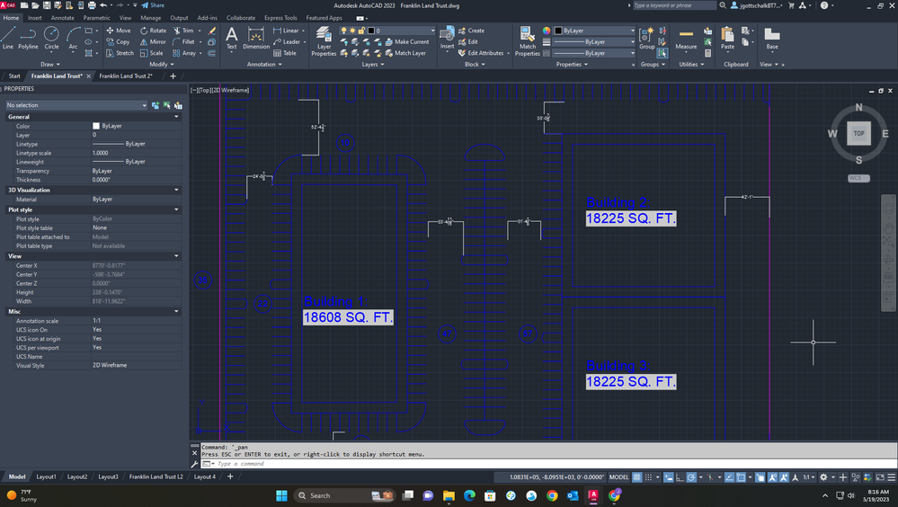

I'm having trouble when putting my drawing inside a view port of the layout, the scale of the drawing loses accuracy.
Everything in my drawing is to the correct dimension and was drawn at 1:1. When I put the layout of the drawing in an 11x17 the scale no longer holds up. The scale that ends up fitting the drawing page ends up being 1:600 however it's far from accurate. I've checked the plot setting to ensure a 1:1 plot scale and the layout plot area before plotting and even after dimensioning the plot it should be around 1:50 that fits the drawing. i have attached a few screen shots to help clarify my problem. Thank you. 11x17 page is measuring correctly11x17 page is measuring correctlyplot settingsplot settingsunit settingsunit settingsthe drawing in model with everything sized and proportionalthe drawing in model with everything sized and proportionaldwg unit commanddwg unit commandEven though the drawing shows this accurately at 33', the scale shows this at over 200'Even though the drawing shows this accurately at 33', the scale shows this at over 200'

600 is 50×12.  So I would say it is a foot/inches conversion to feet  the scale is eith 1"=50' or 1"=600" which is the same.

Since this is an imperial (foot-inch) drawing I would choose one of the standard foot-inch scales for the vport from the list like 1/8”=1’-0” or if that doesn’t fit then try something smaller like 1/16”=1’-0”

Thanks a 1/32 scale does fine! However how would I go about getting the engineering scales accurate?

Not sure what you mean by accurate. If the drawing is drawn accurately at 1 to 1 then selecting those Engineering scales from the list should give you an accurate output copy. Perhaps you can share your drawing for everyone to take a look?

Your drawing is drawn in inches, there are 12 inches in a foot.  You wont be able to get enginnering scales to work with it, unless you scale everything down by 12 and work in feet, not inches.
