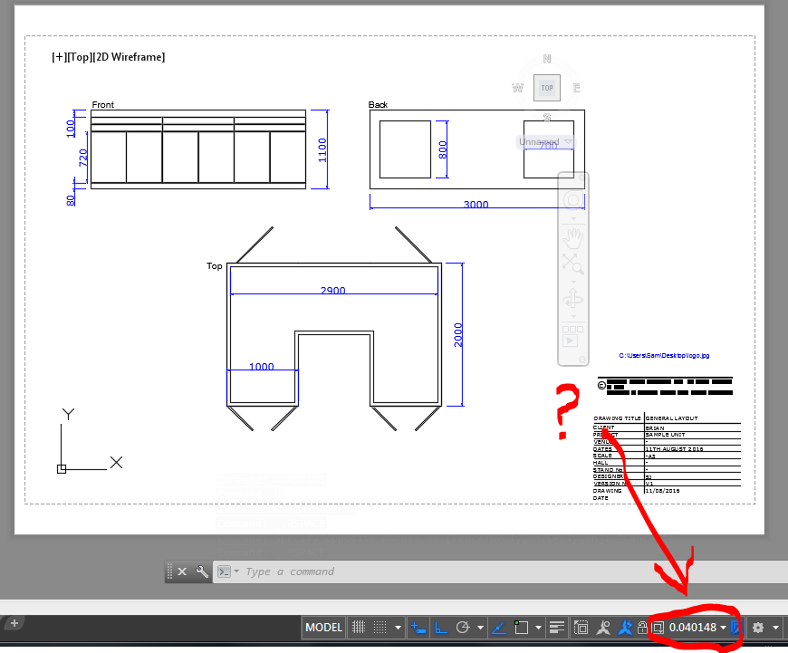

Scale drawing plotting
I have a template that I work from with sheets that are set up (A3, A4, A1). When I have drawn a floorplan and, for example, I put it in the A3 sheet and scale it : Z (enter) Scale (enter) 1/75xp (enter). I then click the plot command at the top and save the PDF, where I send it to another computer to print on an A3 sized paper. I check it with a scale ruler and it is wrong.
Can someone suggest a solution to this problem?

When I enter the viewport in the layout A3 GA (looks like your PDF) it appears to not be set to any scale. So all of your output will be not-to-scale too.
What scale is your viewport supposed to be? Fix that.

Hi @Anonymous,
The files you provided are already to scale.. I plotted the PDF and measured some lines.. The scale wright..
Just make sure - as @pendean mentioned - to use the "Actual Size" in the printing settings in your pdf reader application.. (not shrink or fit)
(For ex. 2500 mm after plotting should measure 33.333.. and it was..)
