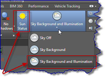

Alfred.NESWADBA
your roof material is set to color 0,0,0, which is the deepest black. Even the most intensive light can't change black to anything else.
The changes I made to get it more light:
Set the camera view as current
Changed the "Black Targa" material to a grey color instead of deep black
Turned on Sky Background and Illumination.
That's what I get after playing with the time (for the sun position):
Is that the direction what you are looking for?
