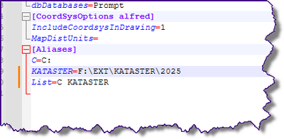

In the meantime (guessing you mean Map 3D / Civil 3D command _ADEDRAWINGS ==> assign) you can search for the file "acadmap.ini" for your current Map 3D / Civil 3D program data path, like
C:\ProgramData\Autodesk\C3D 2025\acadmap.ini
(for Civil 3D 2025)
There you'll find (using a text editor) the defined alias definitions, which can then be copied to the file "acadmap.ini" for your new Map 3D / Civil 3D version.
HTH, - alfred -
