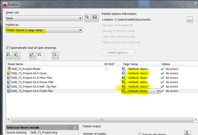

Hello Everyone,
I am trying to publish multiple drawings as pdf file on AutoCAD2016.
Page setup for same has been in place but, once click on Publish to menu & select PDF i get error saying "The Plotter configuration cannot be used for one of there reason: the preset cannot be found, the device cannot be found, or the drive has a problem.
Note - (Please refer attached screenshot for ready reference)
Also, Publish & Publish option menu becomes deactive.
on same menu there are options such as DWF, DXF those options are working well but, once i select PDF i get error mentioned above.
Is there any way to change/edit these settings?
I have also tried re-installation of AutoCAD2016 but, issure remain open.Screenshot Error2 2016 AutoCAD.PNG

Good morning Pradip,
I am sorry you are having the PDF publish problems! It sounds like you might have a damaged PC3 file.
Please tell me, are you able to print to one of the PDF drivers using the Plot command? If so, can you tell me which PC3 files work for you?
Please also try logging in as a different user on the workstation using full administrative permissions. Please let me know if the problem persists.

Wanted to say resetting to defaults worked. Found a problem under our Printer Configuration Search Path that caused this. Resetting path fixed the problem. Thank you. Did not see Accept as Solution button on this page.

Let's try this:
Open and assign each layout to the AutoCAD PDF (General Documentation) PC3. Save the drawing(s).
Next start the Publish command, Select Plotter named in page setup for the Publish to: field. Publish the set with those defaults and let's see if the problem still presents. IF that works, the next step is to do the exact same thing but to add a step where you select all the Default Page setups and override them with an imported one - perhaps the DWGtoPDF PC3.
Please let me know your results.
Please hit the Accept as Solution button if my post fully solves your issue or answers your question.
