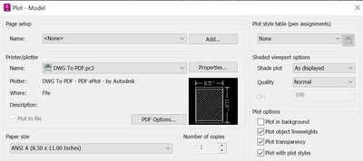

Valentin_CAD
@antonia_pecoraro02 ,
Please provide a drawing.
When plotting, use the DWG to PDF option, and check your Plot style table.
Also, check the Linetype Scale in Properties:
Or this:
