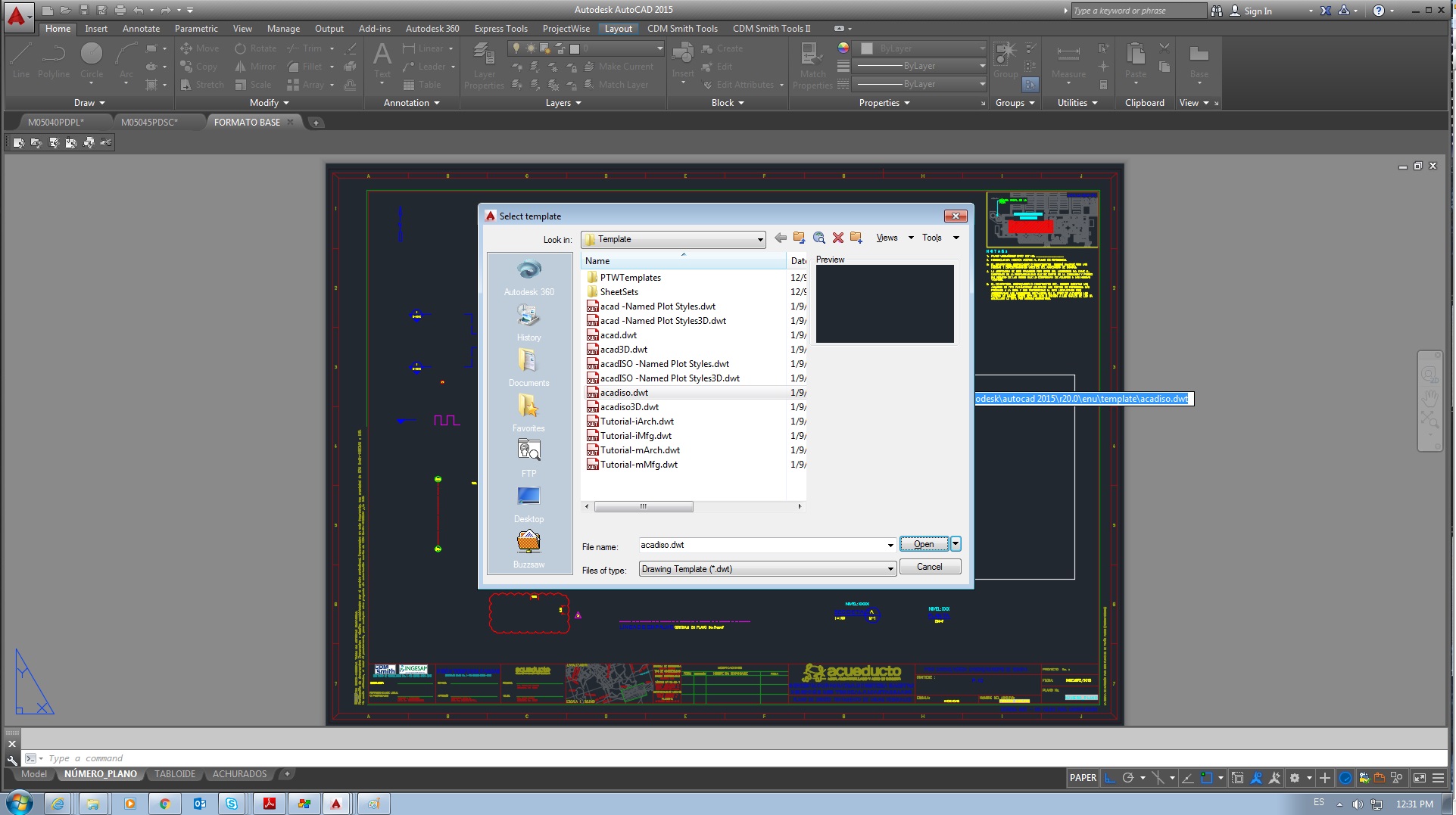

I have created a template whit the sheetborder and some bloccks whit attibutes, and use like a template, everything was created in metric units
So, i was working whit Autocad 2014, and everything was okay, recently  installed Autocad 2015 and i  had problems whit the units when i insert the layout template in a new file.
these are the steps I follow to insert the layout template into a new drawing
1
2
3
4
5
6
7

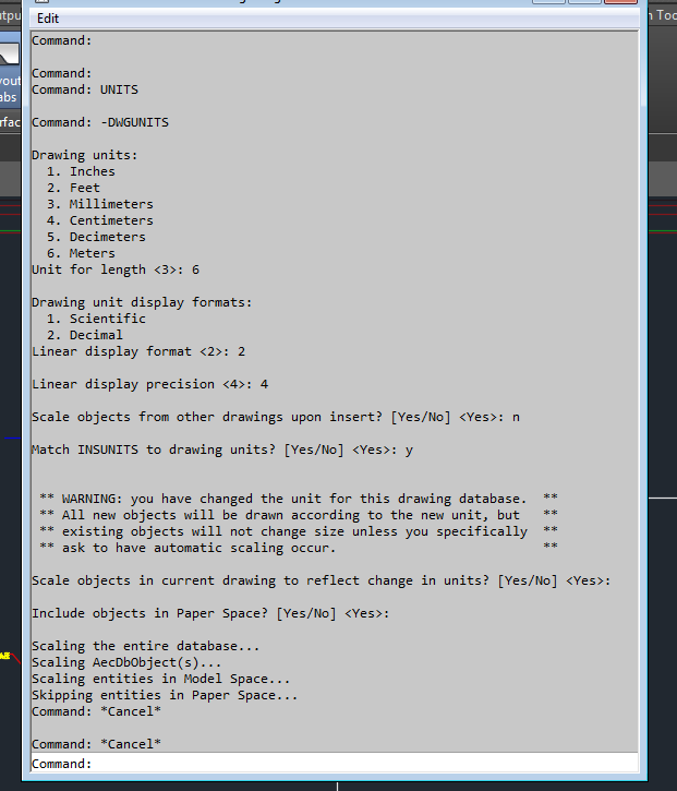

I try using the command 'Dwgunits whit this configuration,
but i cant  do this  and need Each drawing a definitive solution I think it is due to a conflict in the units of the new drawing, but can not find the cause  much less the solution , who can help me thanks.

不适用
they are in the same value
insunitsdeftarget 6
insunitsdefsource 6
are the same 难过表情

不适用
Hi, i used at the beginning like show in the second image i think, but dont work, thank you anymway 😄
