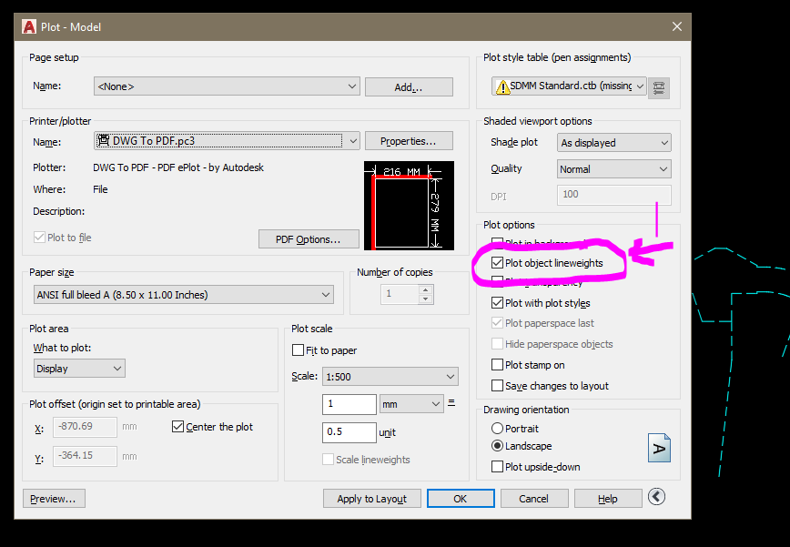

My lines, even on the same line are showing different weights once printed.  Some where between print preview and printing the line weights of any drawing that I am working on mess up and some of the lines on the exact same layer are bolder than others, no elevations, no widths, and exact same properties.
I have printed on 3 different printers and tried to make pdfs and all result in the attached file.  The only time it looks ok is on the screen or in print preview.
Anyone run across this?  Any solutions?  Is there a setting I need to be checking?

try to use "DWG to PDF.pc3" as plot device instead of Bluebeam,
[EDIT] file attached that was created using "DWG to PDF.pc3" [/EDIT]

You have different LWEIGHT settings assigned to many objects. If I remove them from the area of your screenshot at the dashed lines/arcs, and use MONOCHROME CTB file, the problem goes away for those dashed objects.
What version of AutoCADMAP are you using? What are the pen settings in your missing SDDM ctb file?

That is a setting of your operating system how PDF files are opened, has nothing to do with AutoCAD
>> A very odd solution in my opinion and probably will not get
>> used by anyone my office
That sounds interesting. I have shown you how it works, how your lineweights plot well, and even that without the need of buying a product, you you think this is odd.
From my opinion if a build in solution works I would always prefer this way than to use a 3rd party product.

For now we know: same Windows and same AutoCAD do not show this issue using other drivers than the Bluebeam.
It might depend on a combination of all together, but there is no setting for doing wrong or correct lineweights.
One thing to mention: lineweights, when rastered, could also depend on the resolution of the output. If Bluebeam has the option to set the PDF to a higher vector resolution then try that.

Do you just need to uncheck this box?
