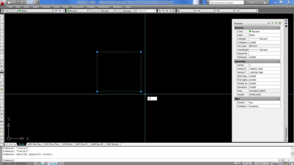

My previous version of AutoCAD (2007) allowed me to choose the items I wanted to hatch first, then when I entered the Hatch command, all I had to do was selectt OK, and the objects would be hatched.  Simple!
Does anyone know how re-create this?     Is there a setting I need to change?
To be clear, now when I pre-select an object, and type "hatch", it takes me to the dialog box, but I need to "re-select" the object, where in the previos version all I had to do was hit "OK", and it would hatch the pre-selected object.

Sorry, I guess I need to explain this a bit further:
previously, I could pre-select an object. Then when I entered the "hatch" command, the object(s) I wanted to hatch were already selected.  However, This option no longer works.  Now, even if I have preselected an object, once I enter into the hatch command, I have to re-select the objects by going thru the "Add: Select Objects" button.
I'm trying to bypass the current protocol and recreate the previous ability to "pre-select" an object to hatch.

danman_enterprises
Just installed Autocad 2016 and the new steps of having to type "P" then enter to re-select the objects I want to hatch is frustrating me!!
This is how hatching works in Autocad LT 2010, can I make 2016 do this?
Step 1: Select object to hatch, type "H" press enter.
Step 2: Click "Add: Select objects" (Note: Pre-selected object still selected)
Step 3: Object has been added, no need to type "P" then enter. Just click "OK"
Object Hatched!
