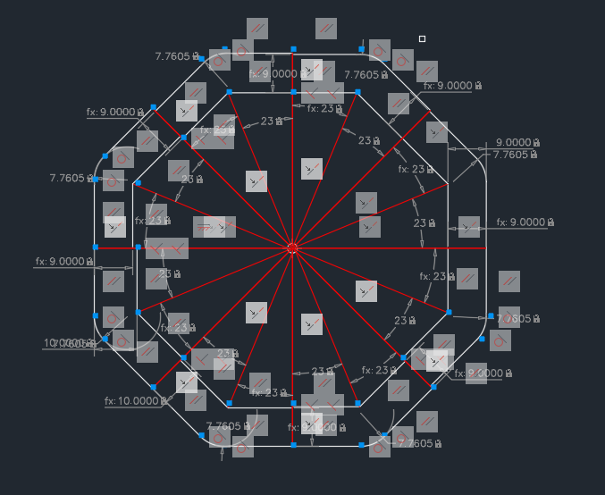

As per the title the constraints/parametric aspect of this product has been performing awfully. I've been having a mass of issues which I don't have the time to write out fully now but I will attempt to describe some of the issues as best I can below.
I began with a basic square with equally chopped corners (thus an octogon with 2 sets of 4 equal length sides). After managing to lock in the shape (not an easy task by any stretch of the imagination! Note: in the attached file I simply locked the segments in place, nothing at all like what I need in reality it just helps to avoid apparent (false) constraint conflicts when offsetting) I attempted a basic offset with the intention of spacing this out exactly 10mm equilaterally... Except that every single line segment loses all sense of association with the line from which it was just offset. The only relationship maintained in any sense of the word is the links between each segment. So instead of a basic 1 step operation in the fashion of Inventor the following 17 tasks are required:

So having managed this first step then comes the next issue. I don't just need the octagon, I need rounded edges, the center of each arc lying on the parent corner. Applying a fillet with radius 10 to every corner as needed does this... except there is no constraints in place and absolutely no link between the corner and the center of the radius. dragging any of the outer ring distorts everything completely. AutoCAD apparently lacks the ability to constrain the centerpoint of a fillet to anything? I've googled quite extensively and spent the day trying but to no avail. This unfortunately means I am left manually hacking at it to get the centerpoint to stay where its needed. The best solution I found was to set a fillet to the same offset (10mm) and set all fillets to be equal to that fillet.
Now that has one very basic octagon with an offset and rounded ring around it, one very small fraction of a task and yet it took several minutes off roundabout messing to gain any sort of progress. Its also a rather useless ring for several reasons, not least of which if I cut the ring in any location it removes all those carefully crafted associations and we end up with the crumpled bag result very shortly. I don't pretend to have offered up an even remotely elegant solution, it frankly sucks but its about the only one I could find that didn't immediately self destruct itself part way through the process.
It frustrates me no end that such a basic task requires such a tedious solution. Surely I am missing some rather important factors? Does AutoCAD really lack the ability to snap to the centerpoint of a fillet for example (yet I am able to snap to the center of a circle/arc/diy fillet with an arc, 2 coincident and 2 tangential constraints)? Is there some option somewhere to make the necessary associations with the original segments when it comes to offsets? Why is it that explicitly giving it the command to offset by 10mm it doesn't also insert the dimension ensuring it remains thus?

I could not follow all the problems you mention  but will agree that AutoCAD's parametric constraints does have it idiosyncrasies.
I think your goal was to create an octagon and then another octagon outside of it but with rounded corners.  Additionally you would like to be able to use parametric features to modify dimensions of the geometry and have the shapes automatically update. Something that looks like this.
There is more than one approach for any geometric construction.  Here's one the worked for me and yields the results I think you want.
Create one eight of the design and use AutoCAD's polar array feature to finish the shape.  The first decision in this approach is to decide which eighth of the shape to create.  I decided I rather have a full arc and the straight sides as two pieces.  Here's the parametric result.
Note that the red construction lines are part of the constraints but on a different layer.  The angles are 22.5°. The red lines have collinear constraints.  You can edit the 10  dim and the radial 7.76. dim and the shape updates appropriately.  The next step is to use   arraypolar   with the ASsociative option set to No and the Items set to 8.  This results in the following where the original linear dim (10) and and fillet radius value can be edited.
I did try using an associative polar array but it was too difficult to edit the shape.

@beyoungjr thank you for the kind words.   I've used many different parametric modelers from Designview by Premise in the 1980's (created by Jon Hirschtick) and later PTC's ProEngineer (which became  Creo) to Solidworks and OnShape (both also Hirschtick companies) to Inventor.  Of all of them I find Inventor the most helpful in resolving constraint conflicts.
In resolving @Anonymous 's challenge there were a few traps.  He was working with a single polyline which did not allow him to reference individual line and arc segments.  It is true that you cannot constrain the center of an arc directly with AutoCAD's parametrics but the tangent constraint enabled the same result. I wish there were a way to easily reference  the intersection of two lines as a constraint.  Instead, I used two lines segments that shared a coincident point and  a collinear constraint.
I used an associative polar array in my first iteration.  Although I got the desired result I found it next to impossible to isolate the original parametric instance to edit and the update the rest of the array.  Opting for the non-associativity may be a little less elegant but enables easy editing.

Regarding your solution (much appreciated btw, thank you) I do have a few questions which is largely what prevented me going this route. I had used the array approach almost exactly as you did it with one exception: the associative option set to yes. I was under the impression (not that I had googled I'll be honest, but extrapolating from the name itself) that ticking the associated box would mean all elements of the array were associated and by extension should all update as the master was updated? It seemed to work somewhat like I thought it would but simply adjusting the values would trigger all sorts of errors and I ran into the latter issues described in my post which basically rendered that entire file useless, a corrupt of sorts.
I downloaded your file there and opened it up and I note that you ran into the next issue I faced with that particular solution. By attempting to manipulate any given line segment the shape falls to pieces (or when using the center guide line of each segment tears the individual component apart). This applies also to any constraints acting upon the segment at a later date (this basic shape is simply the first stage). I attached your file immediately after dragging on 2 line segments where you can see both the freedom to move and the freedom to warp come into play.
For the array to work in my situation I need the center of the array to remain thus for the entire array. At the moment the array option kind of duplicates the segments but just throws them in position without anything keeping them there... which unfortunately means the next time I do anything the end up falling apart 😐
Another nice-to-have (although yes I am aware there are many work-arounds) would be for the 2 line segments (which in reality are one and the same line) to be constrained both collinearly and coincidentally at the end points. Unfortunately (so far as I can tell) the only way this can be done is manually?

@Alfred.NESWADBA  I stand corrected.  What mislead me was that when adding a dimensional constraint between the end of a line and the center of an arc is that when you click near the end of the line you will see the "X" in a red circle glyph at the end of the line indicating (to me) that a parametric point is being established while when you pick the arc (with osnap center) you only see the normal osnap center glyph. As you indicate, the center of the arc is in fact parametrically contrainted by the dimensional constraint.  Thank you for the clarification.

Your statement: "Instead, I used two lines segments that shared a coincident point and  a collinear constraint" has me puzzled somewhat. I thought that would be the logical next step in locking the shape in on the file you sent through but your statements seems to imply you had already done that? If you had it doesn't show up on my system unfortunately, are you able to clarify what you meant there?
I've edited the colors of the base drawing (03) from my earlier post so that you can see that what looks like one red line is really two lines.  The red and green lines have a coincident point (at A) and a collinear constraint.  The same is true for the yellow and cyan lines (at B).  Two lines are used so that a vertex can be referenced and constrained by the 10.0 dimensional constraint.   The resulting geometry can be used in a polar array (non-associative recommended) to complete the design.
I do not follow your statements about not being able to add additional constraints.  Please be specific and include an illustration.
