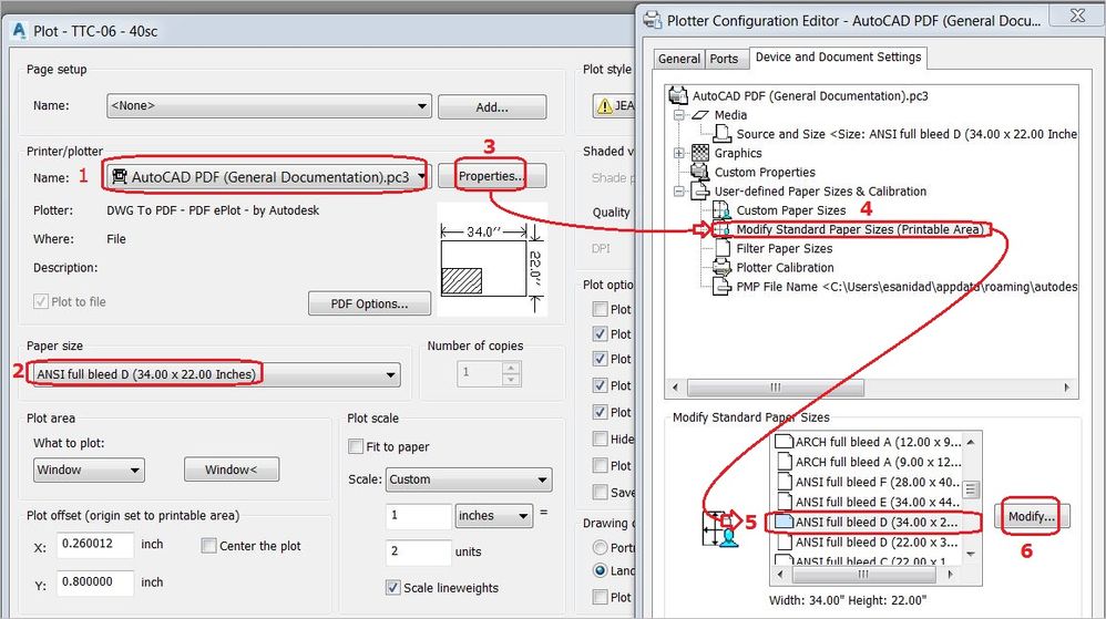

Your layouts, by layouts I mean the printing environment, commonly referred to as paperspace, is using a sheet size commonly referred to as ANSI-D. Do not confuse ANSI-D with Architectural-D, the former is W34"XH22" while the latter is W36"XH24". For your layout to work, you have more than one option. The easiest way is to keep the settings as they are. Make no mistake, if you choose to go the hard way you'll have more settings to adjust. Particular attention should be paid to 1) Paper size = ANSI-B 11x17 and 2) Scale: custom=>1 inch = 2 units. These two settings ( 1 & 2) are the key to getting your ANSI-D W34"xH22" layouts to scale correctly onto an 11x17 sheet. WARNING: if you combine these instructions with other instruction, then your prints may, or may not, scale accurately.

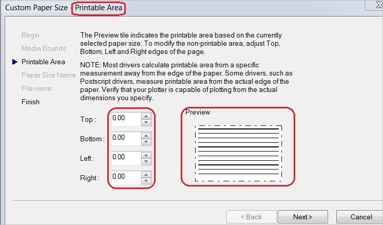

Important! You also have a 'No Plot' area on your layouts and will cause issues. You can tell where nothing will be printed by the dotted line adjacent to the edge of your sheet. The area from the dotted line outward toward the edge of the sheet is the no plot area and regardless of the settings in your plot dialog, it is off limits to your printer's ink head.
Why AutoCAD places an off- limits area on your sheet is unknown to the civilized world so you'll have to deal with it. Users who are aware of this believe the no print area should be determined by your printer, not by Autodesk, while many users don't even realize what the dotted line represents or how to manage it. The best way, is to eliminate the no plot, off limits area by reducing the area between the dotted line and paper edge to zero. You can put the dotted line directly, and precisely, on the edge of the sheet by  going to Printer Properties>User-defined Paper Sizes & Calibration>Modify Standard Paper Sizes (Printable Area). From this setting you can 'move' to dotted line to the paper's edge.
It is important to move the dotted line because it may prohibit 1) where your printer may, or may not lay down ink and 2) determines the 0,0 point, or origin when you place your titleblock onto a layout.

You are trying to control your final print using Adobe Acrobat. It is better, much, much better, to control your print using an AutoCAD PDF.pc3 configuration. So far, you have done everything in AutoCAD. You have already drawn, dimensioned, hatched, annotated, inserted, copied, pasted, scaled, trimmed, rotated and every other imaginable thing directly in AutoCAD. So why are you choosing to ues Adobe Acrobat to CONTROL your print settings?
Keep your print settings totally within AutoCAD too. You can control your plot by doing this:
1-Make your print settings as shown above. Notice the sheet description in 2 and 5 are EXACTLY the same.1-Make your print settings as shown above. Notice the sheet description in 2 and 5 are EXACTLY the same.
Your current layout is configured for ANSI-D. Your pc3 settings are not valid for all sheet sizes, they are applied on a sheet-by-sheet basis. This means every 'sheet description' has a unique pc3 setting. If you use the EXACT same sheet then you'll be fine. If you change from one sheet description to another then your settings will have to be copied and re-entered to a new pc3 file so I recommend you use the EXACT same sheet, e.g.  ANSI full bleed D (34.00 x 22.00 Inches). CAUTION: there are several ANSI-D sheets, each with a different description, so be careful when choosing.
2-This is how you eliminate non-printable areas. Watch the dotted line move to the edge in preview when you make the margins 0.2-This is how you eliminate non-printable areas. Watch the dotted line move to the edge in preview when you make the margins 0.
After you've eliminated the non-printable areas by moving the dotted line to the paper's edge, click NEXT, then FINISH. In the next dialog window, you'll perform a SAVE AS on this PC3 file. You will want to OVERWRITE the existing PC3 named AutoCAD PDF (General Documentation).pc3 so the next time you do this your settings will be reapplied. When you are asked, You have made changes to a PC3 printer configuration file, choose 'Save changes to the following file' go ahead and keep the DEFAULT file displayed and click OK. You will return to the Plot dialog window where you can review your settings. They will look like the image below.
.3-Your final settings will look like this.3-Your final settings will look like this.
