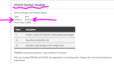

See this from HELP
Now you know it is a per-DWG file setting: it appears someone either went through all of your DWG file to reset them, or you still have a startup that is taking over that is still not removed (not unloaded, REMOVED).
