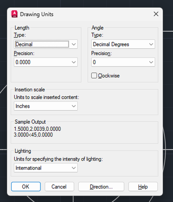

First I would say start with the correct units in your drawing. Use the UNITS command and set them appropriately.
