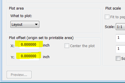

Hi Mark, Yes, that is the plot margin. If you go into your page setup and select the properties for your selected printer then you can reduce the margins to 0 if you follow the images in my previous post. If that isn't clear let me know.  I also did a post a while ago that shows how to create a custom PC3 file that shows this operation.

You will notice in your Pagesetup that at the bottom left corner you can adjust the origin point. Sometimes a slight negative or positive value is needed for your border to align exactly.
