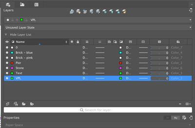

Hi Everyone
We've just updated to Autocad 2018 on the mac and in the Layer Manager I've no option for Non Print layer.
Please see attached image showing the layer manager and the options, none of which allow us to turn off print.
Has this command changed? If so how do I now make a layer non print please?
Thank you.
Craig

Hi and Welcome to AutoCAD Forum,
i suggest while Layer manger is opened to right click over any tab ( see below image ) then see if you have the tabs list , just tick the option that is missed .  hope it's help .

c.r.stott
Imad
That's brilliant. Thank you so much.
Best
Craig
