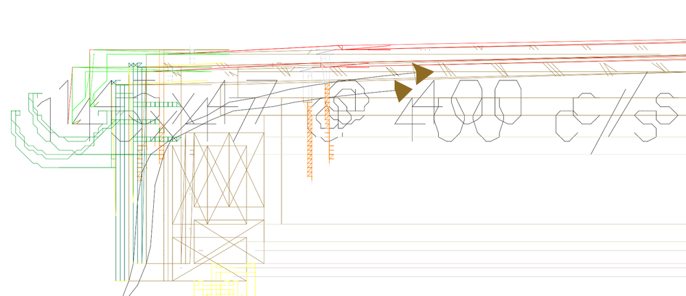

        I haven't got AutoCad myself but am passing file onto another designer on Monday so hopefully they can confirm ! As a quick check when you look at the file in AutoCad do you see multiple lines overlapping (as in screen shot below) or does it look 'normal' ?

Looks normal - here is a screenshot of part of the modeltab
