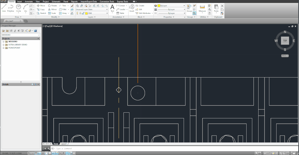

perplexing line length bug: what I enter isn't always what I get

See the screencast below.  What on earth could be causing this?
Edit: added 2nd screencast below.

ChicagoLooper
Hi @mikegera
Try this:
  1. Select the objects you are measuring.
  2. Right-click=>click Isolate=>Isolate selected objects
  3. Change the View Cube to from TOP to FRONT.
  4. Zoom-in. Are the objects on the same plane? Is one higher than the other?
  5. Right-click=>Isolate=>End isolation
If the objects are at different elevations, your dimension won’t be accurate.

mikegera
Hey @ChicagoLooper ,
The circle and the line are both on the same plane.  But, I did notice that some entities in the assembly I'm working with are not, and that could be affecting things.
What is the best way to push everything in the drawing to Z=0?
Thanks.

ChicagoLooper
Solución aceptada
@mikegera
Use FLATTEN command.
Express Tools
tab in the Ribbon=>Modify panel=>click the drop down arrow=>click Flatten Objects
Chicagolooper

TomBeauford
Were the assemblies drawn by others? AutoCAD is a 3D program and those elevation values may be important.
Better solution if you don't want you additions to use elevations would be to set the OSNAPZ (System Variable) to 1 and make sure the ELEVATION (System Variable) is set to 0. Any objects or dimensions you add using osnaps will be with an ELEVATION of 0 without converting the entire drawing to 2D which might make it useless to others.

mikegera
Hi Tom,
Thanks for the very helpful rely.   Often drawings are a mix of blocks from many sources.  Sometimes, I don't realize that there's 3D content.
Is there a way to globally "turn off 3D"?  i.e. outright "disable Z"?

ChicagoLooper
Hi @mikegera
Cannot 'disable' 3D elevations.
Use FLATTEN command to move the objects from their current elevation to Z=0 so they're all on the same Plane.

mikegera
For some reason, the FLATTEN command does not always work.  For example, I found a text entity that had a nonzero "Position Z" (21.3655).  FLATTEN did not change its Position Z to zero, it remained at 21.3655.
I also found that FLATTEN cannot penetrate blocks.  Is there a setting to allow it to do so?

ChicagoLooper
Hi @mikegera
Do you know whether this drawing began in Revit?
Yes, it did or no it didn't? I don't know and I don't care?
Is it possible to upload more screenshots?
Select a text entity nonzero "Position Z" then upload a screenshot with the text is still selected. Include the Properties Palette in the shot so the text can be evaluated.
Next, select a block which cannot be penetrated  and upload a screenshot with the block is still selected. Include the Properties Palette in the shot so the block can be evaluated.
BTW, do you run Revit? Is this an architectural drawing?

mikegera
Chicago,
1.  Sorry for the delayed response.
2.  I do not use Revit.  While I am not the originator of the drawing in question, I'm nearly certain that Revit was not used at any point.
3.  This is not an architectural drawing.  It's an electrical schematic.
4.  I did make an interesting discovery: the issue is NOT present in AutoCAD mechanical.  It IS present in AutoCAD electrical.

pendean
Community Legend
Community Legend
@mikegera wrote:
...I did make an interesting discovery: the issue is NOT present in AutoCAD mechanical.  It IS present in AutoCAD electrical....
I have both variants, 2023 versions, as do many others around here I suspect: can you share a DWG that exhibits this?

nrz13
If you can figure out the FLATTEN issue to get it to always work, you could set AutoCAD to run a LISP each time a drawing is opened (in your acaddoc.lsp file) that flattens it first.  It would do it for every drawing you open, even one that's already been flattened, but it would keep you from accidentally working in a 3D drawing.
