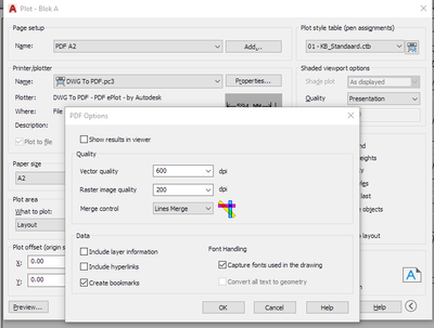

I thought there would be a plot setting I could change to remedy these issues but have not been able to find one. Checking the boxes on or off for "Capture fonts used in the drawing" and "Convert all text to geometry" has no effect on the plot. Increasing the vector quality from 600 to 2400 DPI also does not smooth the plotted edges.

Should be 'smooth sailing'. For some drawings, we use the default DWG to PDF printer.
This will capture the text as text in the PDF. In the new plot sample, the text is created as image. Do you happen to use a copyrighted font?

Hello Simon_Weel,
I am using the default DWG To PDF printer and have tried toggling the "Capture Fonts Used in the Drawing" setting on and off with no success. This issue happens with multiple different TrueType fonts. Normally we use Arial.
With some further testing I have just discovered what is causing the issue: the setting for text Width Factor. Changing this setting to anything other than 1 causes both the automatic conversion of text to vectors and the inconsistent edge plotting.
