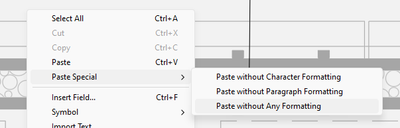

cperrydesign
Does right-click > paste special > paste without formatting not strip the text styles out of what you're pasting?
