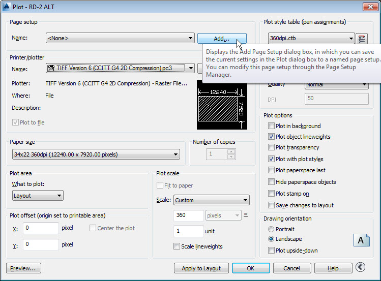

Hello all,
I've run into this problem often.  Its time to see if there is a permanent solution.
When I import a page setup from a template file which is also used for my page setup overrides, and I assign it to my layout, the plot dialog displays <none> for the current page setup name.  I can add the name that I just imported and it'll warn that the setup name exists. I overwrite it and assign it to the layout and then the plot dialog will show that name.  If I reimport it, the problem starts all over again.
After applying it to the layout it will function properly and show as current in the plot dialog until it is reimported.
We have users working on AutoCAD C3D 2013 and I am on AutoCAD C3D 2014.  If I open the template file and set the page setup name there then I do not have the problem any more but 2013 users do.  If a 2013 user opens the template file and sets the page setup name there then they do not have the problem but 2014 users do.
How can I fix this so that AutoCAD C3D 2013 users and AutoCAD C3D 2014 users can use the same template file without causing this problem for one group or the other?
