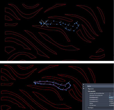

Hello Readers,
I have outlined an image in Corel Draw and exported the file in DWG. When I open the DWG file, some lines are hidden. Instead of the lines, a single dot is visible. The hidden line is shown in a blue-dotted line when that dot is selected. I have attached the file below.
Please let me know what is causing this problem.

Nothin is "missing" just looking at your DWG file (your post's clickbait title LOL), its just not displaying like the other SPLINEs.

Spline nodes on top of another node of this spline ... a lot of them, that'S the problem.
For example the one above <see attachment>, multiple node on top of the next node.
As test, I edited one node position and the Spline displaying.
Node/Vertex 21, I changed the X-Position to 0.97 in my test.
If you have something like a "Clean Splines" tool on Corel, use it and try it again.
AutoCAD can not handle this nonsensical data situation
