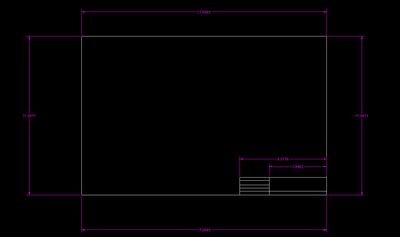

I'm trying to offset a line and its not measuring to what I'm inputting. EX: I offset a line 2.0"  but when I go to check it, its measuring at 1.9442"
I made sure my that my "dynamic input where possible" is on and my "polar tracking" is also on. Not sure how to fix this problem.

I've attached the file and a drawing of what the dimensions are supposed to be.
your titleblock is a series of 3D oriented lines/lines etc.

I have no issues when I make boxes using the "rectangle" draw tool. Everything measures out perfect. But I have to snip all unwanted lines when doing it that way.

Patchy
It's wrong because you drawn with THICKNESS, set it to zero and draw again.

@joserATT wrote:
This did not fix the problem. still not measuring out correctly.
Start over @joserATT : you want UCS and PLAN commands to be set to WORLD, then use RECTANG command to draw each rectangle to the correct dimension, but ensure that your THICKNESS variable is set to 0 (that's a zero) first.

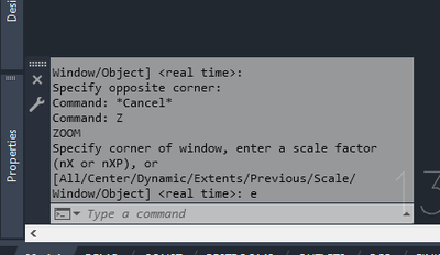

For some reason the dimensions are not showing up on my recording. But this is how I'm offsetting the lines and measuring them. I didn't think there was a way to mess up offsetting and measuring. Seemed pretty straight forward. But I guess not... Hopefully this video answers the "how am I offsetting/measuring" question.
1) turn off all running OSNAPS. Discussed previously in a reply to you. Try it again.
2) are these new 2D only lines, or are you still working with the original file you shared here?
3) Why are you hiding the commandline if I may ask? You might be missing feedback from the program. Don't be shy about making it tall and in a corner (or a second screen)
