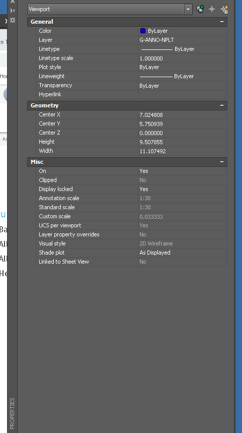

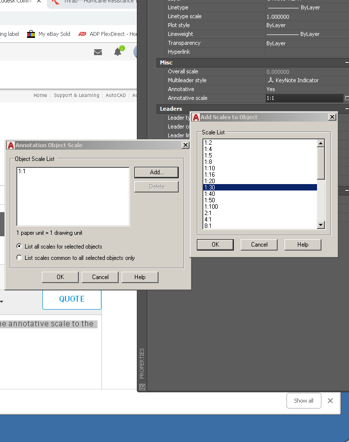

You can fix this easily.  First, move the leaders to Model space.  Then using properties match the annotative scale to the viewport scale. See attachments.  Your viewport is 1:30  change your leaders to that by adding that scale.  You will have to stretch the leaders to fit with the scale.  Once you have the annotative scale that matches the viewport, everything should show up.  You can select all the leaders when you make these changes in properties.leaders in model spaceleaders in model spaceAdd scaleAdd scaleadd 1:30 scaleadd 1:30 scaledelete 1:1 scaledelete 1:1 scaleannotative object scaleannotative object scaleCropperCapture[676].png

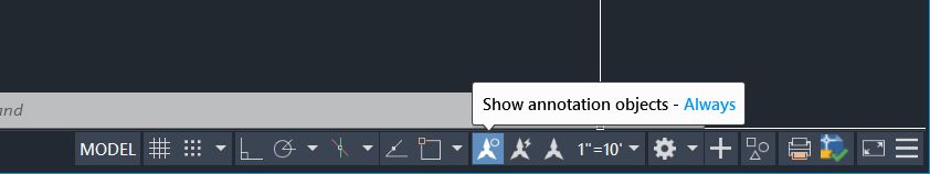

This just happened to me. In model space, I had accidentally clicked off "Show annotation objects - Always". I clicked it back on and my multileaders were visible again in model space.cad.jpg
